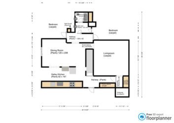

    I worked through the template from video 2 and am uploading to you. Not to scale, but I added the dimensions as best I could (some approximate.)
    That said, a little history. I got the samples from Flooret and used the discount code you had. Thanks!
    I ordered the Ashford (base) with the trim. The Flooret people were very helpful. It’s sitting in my garage waiting (for me to get trained! ha) I also have a plank cutter, tapping block, plank puller, shark knife, and floor spacers. Anything else?
    <font face=”inherit”>As you can see from the attached floor plan, it’s a series of carpet and </font>other<font face=”inherit”> transitions. Too many doors in this house!!</font>

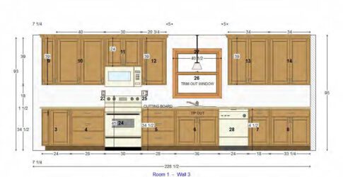

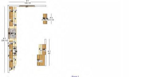

    <font face=”inherit”>In addition, we are remodeling the kitchen with new </font>cabinets (attached blueprints from builder)
    I will need to do the flooring up to the island probably and then wait for the cabinets to be installed (end of May), so I need to get going on this.
    I’m guessing the best place to start is from the bathroom and work my way to the kitchen area?
    I’ll let you determine.
    Anyway thanks & please let me know what else you will need.

      Yes, apologies for the initial vagueness on the first post. The bathroom, 2 bedrooms, living room, and entryway will all stay the way they are with either carpet or linoleum. I tried to put in “plank” wherever the new flooring would be going. Hope that clears up that confusion.
      I do like your idea of starting at the threshold of the bathroom and working to the island. I have all the transitions from Flooret for carpet & linoleum, as well as stair round-overs.
      The tricky part is the cabinet he will be putting over the refrigerator. It will have two sides running down to the floor and as wide as the fridge on either side, wood stained the same as the hickory cabinets.
      The idea, as I talked with the cabinet maker, was to put down the plank floor ahead of the fridge cabinet install. That won’t be so bad if he needs to come back and install that after the flooring is done.
