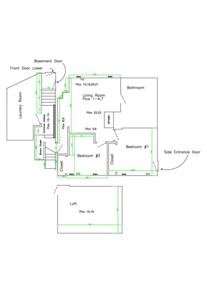

    I’m starting to prep the floor for LVP. I have around 1000 sq ft of flooring to replace.

    Here is the drawing of the project
    LarryB
